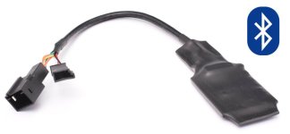

Thanks for the link. I'm not sure if you can answer this question, but what is the connector block adapter for? The BT connection like this one:
Only needs a 3 pin connection to the back of the unit via connector 'C' (plus the requirement of finding a power and ground line), but the one in the link you provided seems to employ the main connector block as well?
Do you think it's because it uses the power from the block or is there something else?
Before you ask, I don't want to be using another block adapter as I already have one behind my radio, so there is no more space.
What I'm hoping to do is buy the one you provided the link to and just use the 3 AUX pins and find my own power and ground lines.
Do you think this is possible?
Last question, (and this may be part of the solution) do you need to be in AUX mode before you make or take calls?

Hi,
Yes this adaptor uses the Aux on the head unit which is what the connector is for, 3 pins and you need to be in Aux mode to listen to music and make calls. The two wires in the main connection are power and ground so yes you can snip these off and get from elsewhere if you want to source someplace else and can just plug in the aux connection.
I actually snapped off the power and ground and soldered them again with some heat shrink for a better connection. If you already have a connector block in there should be easy to take the power and ground feeds from the same location on your block.

Hi, so I got my adapter, and bought the unit with the block B wiring and pre-wired taps for power.
https://ebay.us/IKbXhm
I fitted it into my loom and pulled fuse 48 (as suggested by Mau) but there was a problem whereby when I was playing BT music, I could hear the CD player trying to load or attempt to play the loaded CD. It also wouldn't eject the CD properly. So today I put the fuse back in and all is good. it seems they have updated the compatibility with the BMW system.
Lastly I ditched the microphone that came with the unit as it was quite large. I bought a small one similar to what comes with Pioneer units and fitted it up behind the A pillar (which incidentally comes off very easily) and ran the wire down and behind the steering column.
