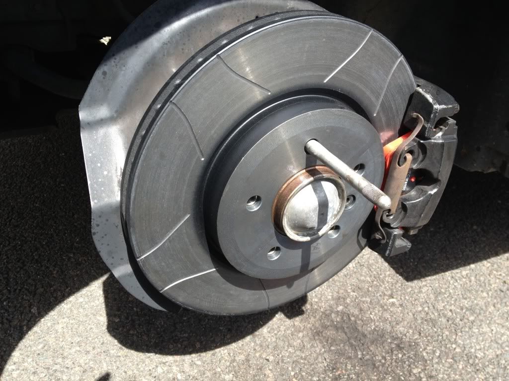

I've just installed some Brembo Max disc and some EBC red stuff pads today on mine. Will need to give it some time to see if its made any difference if any over the standard disc and pads.
