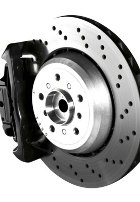

You could go with the little known genuine bmw drilled brake disc option. Standard 325mm and 17” alloys not an issue.
Not cheap though.

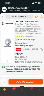

Thanks. Cheaper than changing wheels and buying a bigger brake kit though….

True, a fair bit lighter than the standard disc and pretty as requested. 👍🏻
They are certainly a good price. I don’t think they be as light as the bmw ones, because they look like one piece with less and smaller perforations. But if you do like them they’re £85.99 on the AUTODOC app currently.

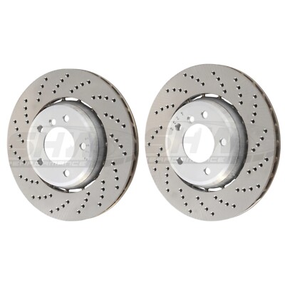

I think it could be shw that make the bmw ones and here’s some on eBay to compare but a lot more money…

@RMB Many thanks, that’s the offer I’m looking at. I’ve not used Zimmerman before but based on previous comments on here, reviews and AI, I can’t see what’s not to like at that price? The car won’t be tracked and the most demanding thing it will do this summer is a drive to Bordeaux, so I’m figuring these meet the use case well.
