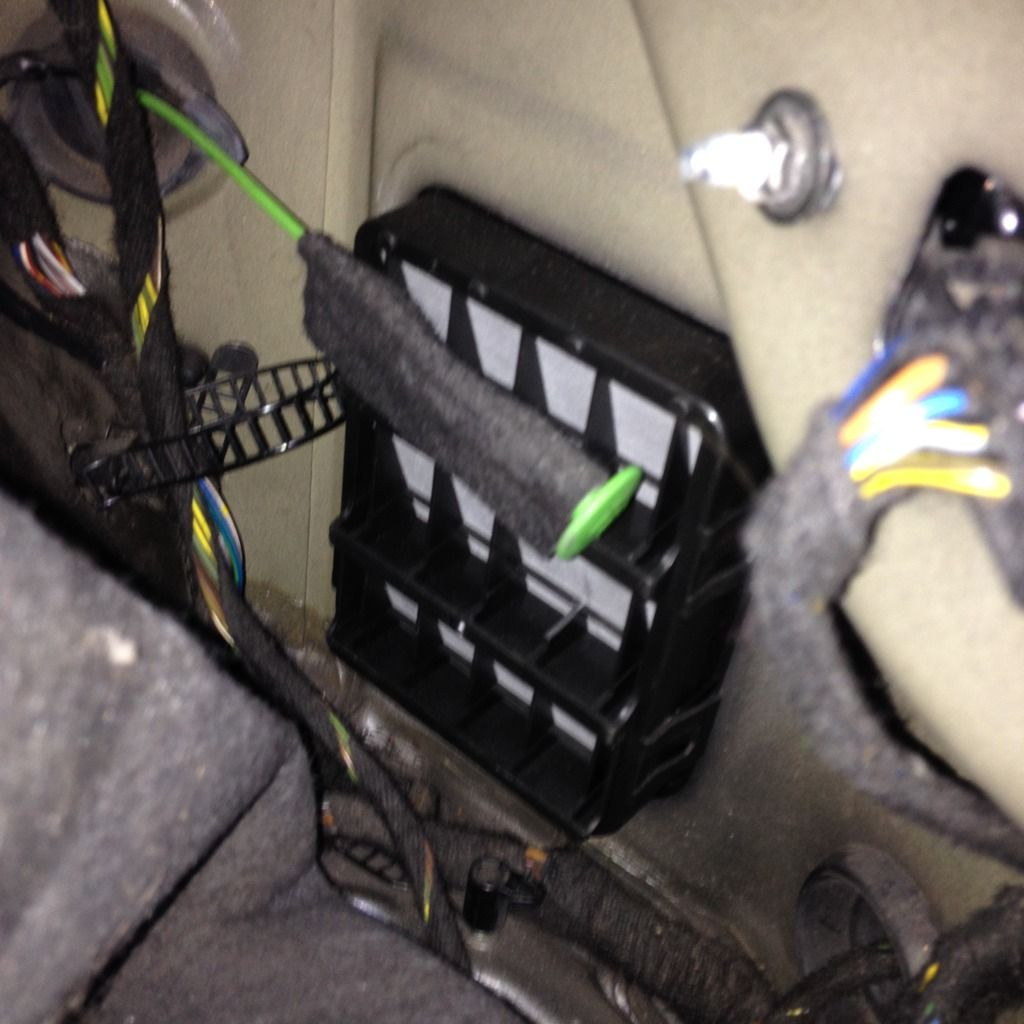

Here you go, drivers side vent in place as it should be. you will see it pushes in from the outside with plastic spring clips to hold it in (2 on each side) My original units had been pushed into place from the inside of the car. The water was leaking past the seals and creating a puddle in the floor pan well below it. The bottom of the foam underlay material on the suspension strut was sitting in it and soaking it up like any good sponge so the water was travelling up! With so much water in the boot it was evaporating and condensating on the under side of the boot lid and raining down on the rest of the carpet. In fact created my very own mini-climate!
