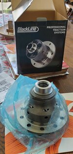

Hi booloveblankie, glad you are enjoying the diff, I certainly am. Did you install it yourself and measure the crown wheel backlash?
Joycey said:
My Blackline diff arrived last week, planning to fit it shortly.
regalis said:

When chatting with Matt lewis racing they quoted the following diff to be the unit for my 3.0si
https://www.mattlewisracing.co.uk/product.php/2899/0/limited_slip_differential_bmw_1_3_series
