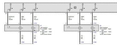

Z4 high beam / flasher non xenon wiring diagram for 2006+
Z4 high beam / flasher xenon wiring diagram for 2006+
Z4 low / high beam / flasher xenon wiring diagram for -2005

So you've found proof that the PFL does have bi-xenons, thanks for clarifying your earlier error in claiming my comment was wrong.
Just because newtis repeats the same diagrams doesn’t mean the prefacelift actually had bi-xenons, PFL had mono xenons where as the facelift had bi-xenons

It's not a repeated diagram, its specific to the prefacelift which has both bixenon running lights and a halogen for 'flash to pass', both serving separate purposes. I expect the reason they were changed in the facelift was cost saving in all likelihood, why use two bulbs when one does the same job.
The reason they had mono xenons with a halogen bulb for flash to pass was the halogen was quicker to ignite. It wasn’t till 2005 before the bi-xenon was introduced.
Yuo dont seem to be getting this. It uses the xenon bulb with a shutter in the projector, which is in place for the diped beam and drops when you turn on the main beam running lights. That is the very definition of a bi-xenon light. Feel free to do your own research to verify this, they use a Hella E44 projector housing, which is a very commonly used model in German cars and has a solenoid actuated shutter.

The wiring diagram you posted literally has bixenon written on it, and is exactly how my car (bult in March 2004, so well before this imaginary 2005 change) functions. The apearance was updated for the facelift, so assumedly they decided it was also a suitable time to drop what was considered a surplus part. After all, saving £5 per item in mass production adds up very quickly.
