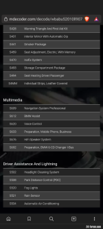

I have a few routes to go down to connect my phone for audio and calls. But would prefer to keep the standard head unit and digital where possible to ensure good audio quality.
My zed has a few factory options added which leaves me with a few possibilities. Just trying to pick the right one.
Options
PXL_20230524_090248624.jpgPXL_20230524_090316430.jpgPXL_20230524_090255662.jpgScreenshot_20230523-124129.png
I see a how to guide on here to use the s692 cd changer I bus prep I have on here to install the following:
Would that be the best option, or is there a simpler solution with the phone prep option I have?.

Your VIN spec, and the photo of the phone cradle, suggest that you should be able to pair your phone to the car for calls (the speech button on the cubby hole door is used to enter bluetooth pairing mode). It is a frustrating process to get right , and you also need to have the bluetooth access code available to you (if you have the original docs that came with the car, it should be on a sticker on one of the booklets), but it's worth setting up in my view. If you search for bluetooth pairing, you should find some posts showing how to set it up.
For audio/media - the Bluemusic adapter is your best option for audio quality (versus a solution that utilises the aux socket), and will also allow you to use your steering controls to skip tracks.

I can confirm that aux has more noise interference, did my own independant testing on this. Went for the bluemusic path which hooks up to the 6CD changer and i think its the best option. you can Play music, enter pairing mode, accept/decline calls and skip tracks all from the head unit. If you have the Multi function steering wheel, all of those work as the car thinks it is interacting with the "CD changer"
Update on this. Got the phone pairing to work though my standard equipment. So thanks to Calps for the set up info on that
As for Bluetooth, I used an iPod adapter for Bluetooth as I wasn't sure if the cable in was just a iPod analog aux... It just about works, but it is indeed just an aux cable, it's a bit quiet and sounds shite.
Will return the adaptor and go down the bluemusic cd changer route as this seems to be the better quality way to go.
