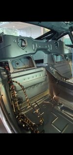

am i right in thinking the e85 has puny 4" drivers behind the seats and can you put say 6" speakers in without hacking everything to pieces ?
There's not a ton of room in the factory holes, but could be enlarged.
Went to a hifi shop the other day and they said about fitting a sub in the boot. Wasnt huge, but said it was the only proper option . Then you can get away with smaller mid range and standard sized tweeters.
Presumably an amp too to drive it, all good i agree, but was thinking of keeping it simple if possible, i wonder if a speaker could be built outwards like a housing of some sort.
just looking at the footwell, that has more promise maybe - is that a 4" tucked in there or maybe something larger ?

Are you referring to the smaller midrange speakers in the rear or are you referring to the subs? The subs are about 6" but the midrange speakers are 4". There's a good post on zpost about the different sound systems here - https://www.zpost.com/forums/showthread.php?t=63030 - in my opinion two 6" woofers is enough to play the bass in the small cabin of the z4, depends on how much excursion the woofers are capable of though of course.
i don't have any subs at all, i have the 2x 4" in the footwell and 2x 4" behind my head , i also utilised the empty 4" slots on the door and put a couple in there .
The footwell speakers are 6.5" not 4"
I have disconnected the 4" rear speakers as they do very little and installed Alpine components in the front powered by an amp. Big difference in sound.
