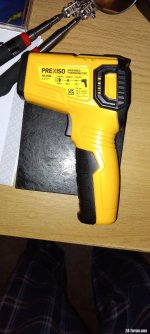

To rule out overheating brakes, get one of these cheap infrared thermometers, hours of endless fun using it. Point it at the discs and calipers to see what temperature they are. Do it quickly as they do cool down quite fast. I would also check for a broken spring. A long shot, but if all the wheels were on full "droop" a suspension bush may have become damaged, check the front suspension top mount.

Thanks, I know those thermometers are very useful, I shall have a look at them.
