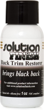

Put some makeup on her in the form of "Solution Finish - Black Plastic & Vinyl Restorer", worked so good I did all external rubbers, hard pastics the stubby and even the wiper arms and hard plastic bits, surprisingly, on the painted metal arms it worked great and all of that makes the car look much fresher. Windscreen cowl is a great example. Might do underbonnet when I feel the courage to detail it!
Advice: wear latex gloves next time!
I really have to change the windscreen trim now as it is in a poor state and really brings downd the aesthetics next to this :(
