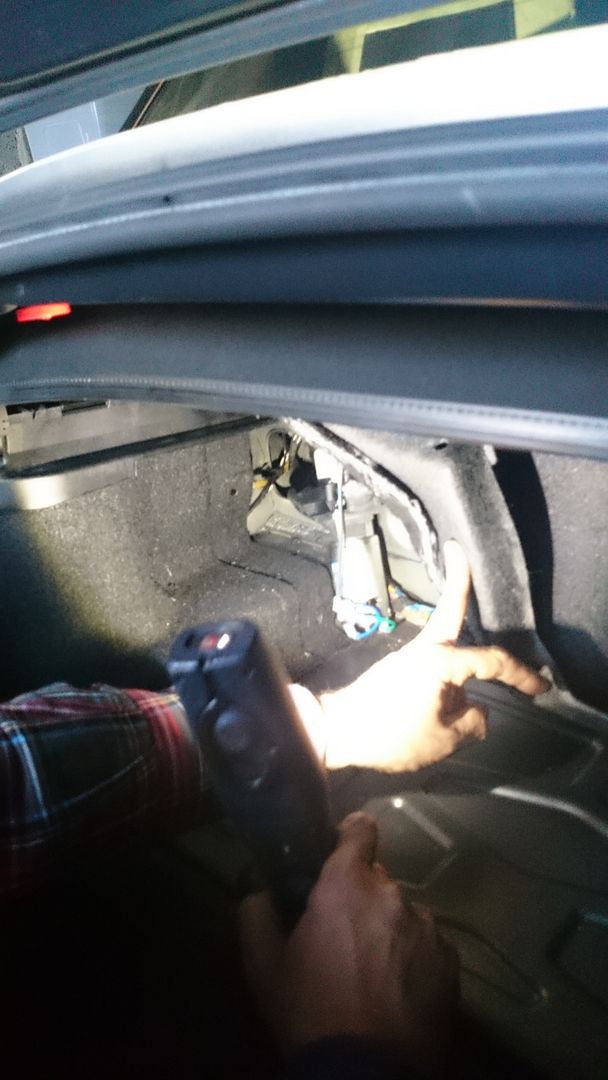

So, Had my roof motor replaced yesterday by Mervyn at Autoelectron, top notch service, genuine bmw motor with 2 year warranty and relocated to the boot :thumbsup: You'd never even know it was in there, made up a little bracket to mount it at the back behind the felt, he still modified my drain holes as thats part of the service he provides. He had not mounted one in the boot before and even though it took him longer than he expected as he wanted it spot on for future installs he didn't charge any extra, nice bloke too and has also owned a z4, cant recommend him highly enough if you need a new motor. All in less than 600 notes :thumbsup:

Did he mount the motor on the bulkhead behind the seats, or on the passenger side near the suspension mount?
Also does it sound louder if he's bolted a bracket to the bodywork?
Mounted on bulkhead, attached a pic, no louder than it was before :thumbsup:
It's a shame bmw never fitted the motor there, would have saved an awful lot of expense for owners!
