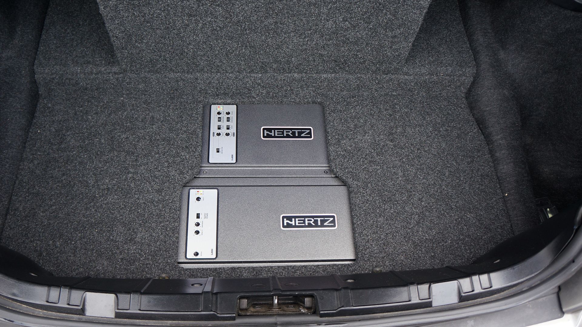

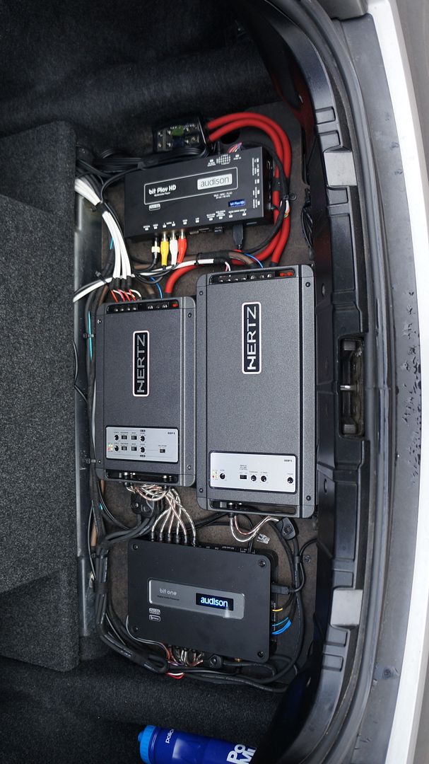

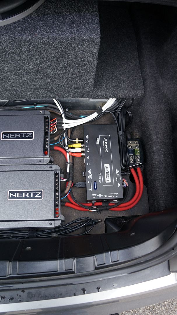

At long last have the audio upgrade completed by Source Sounds of Sheffield. Thought I would show a few pictures of the work done. All the front speakers have been replaced with 3 way Hertz Hi Energy Components, tweeters custom fit to the original position. Mids fitted in the doors and the six and a half inch mid/bass in the floor kick panels. The front speakers Bi-amped from a dedicated Hert 4 channel HDP 4 Amp. The rear 12" sub in a custom made enclosure powered by a Hertz HDP1.

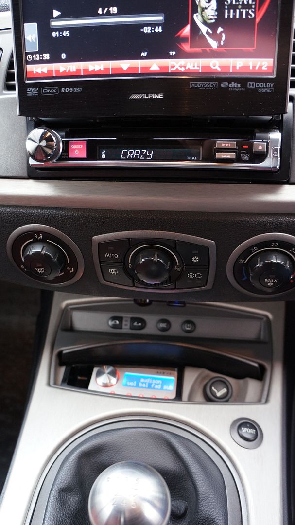

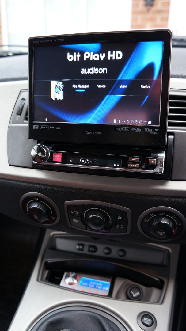

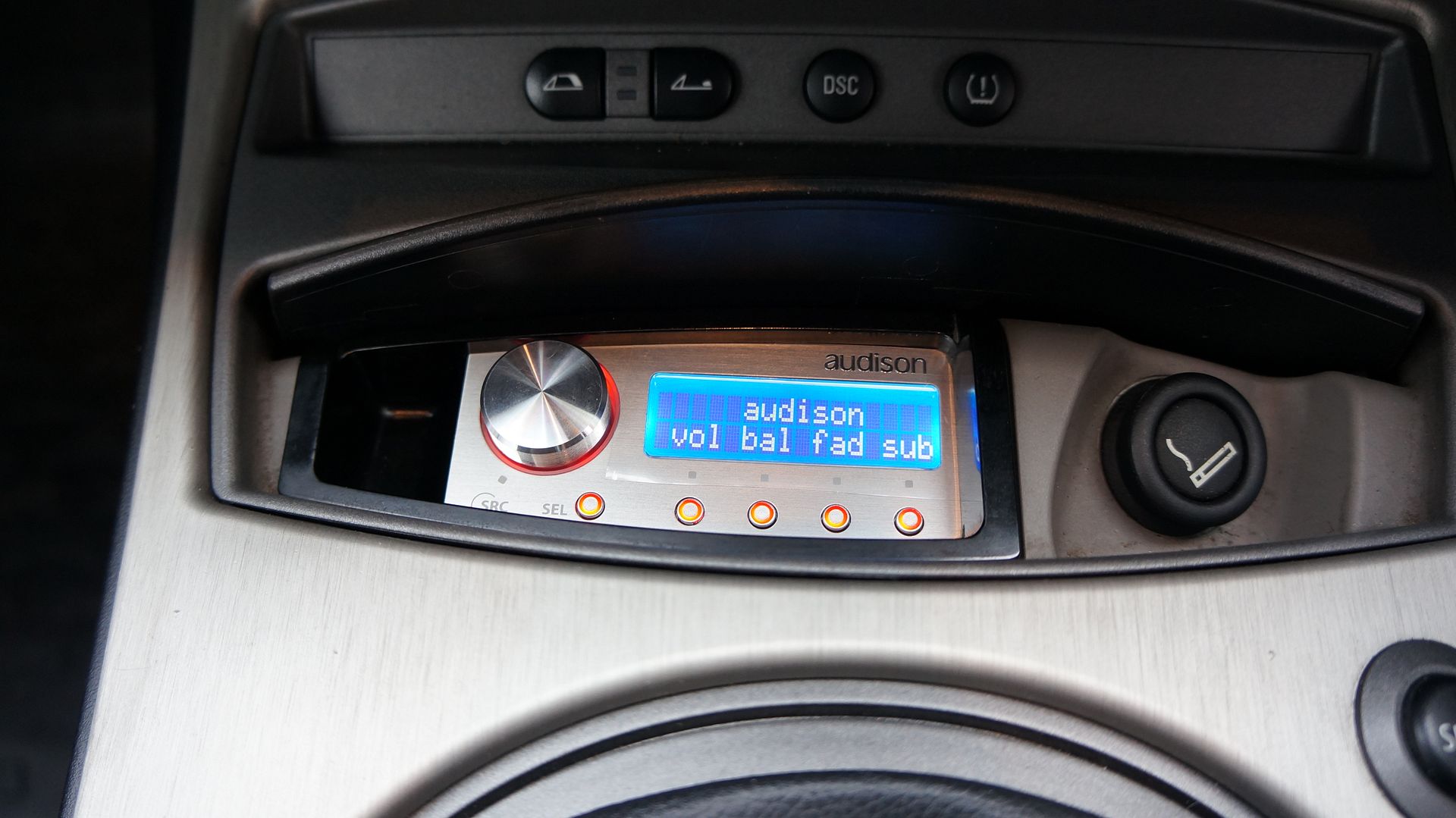

I have then gone for an Audison Bit Play HD and an Audison Bit 1 processor.
I now have 240GB SSD drive on the Bit Play HD with an external 64GB USB stick.

NeilP commented a while ago about not needing any speakers behind you and he was correct. The quality of the Audison gear is absolutely spot on. The only gripe I have is that their software interface is very dated, but I believe is about to be upgraded.

Looks great, I bet that sounds a lot better, What was the reason for the Sub going in the boot instead of behind the seat out of interest?

Alpine head unit with HPD4 and components first.
Then sub
Next was the HPD1 amp
Alpine sat nav add on
Bit one + Bit Play HD

We tried the subs in back but not 10% on the boot enclosure.

I just couldn't justify pretty much losing the whole boot and all that quality sound in a rattly, crashy, 2 seater soft-top.

Turn the volume up.. I have llst about a third of the boot space. Not that its that much anyway.

Easy really. The Audison processor can store pre set levels so I have a roof up and down setting. The higher frequencies are tweaked a few db for roof down.

Tidy! Well done for getting a proper job done. Think I'm going to go Hertz 3-way soon, with no amp/head unit upgrade initially, and go from there. It's when you start routing things front-to-back that this kind of job starts getting expensive.

Those prices are about right but I have a good relationship so got some components cheaper. The issue is finding an installer who takes the time and effort to show what you can do. I am really pleased at the quality of sound and the sound stage this set up produces especially from .wav .flac files. The downside is having to set up the analogue side for the Alpine head unit & the sat nav software. So when switching between the bit play and say FM radio don't leave it set at -6db as the whole street can hear it! If you do go the bit play HD + bit one the software is due an upgrade in January by Audison so should be a lot more slick.
