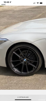

I had a bit of bother changing the wheels over, the winter wheels came of no problem but the Veemanns wouldn’t go back on, on examination the painter had coated inside the hub which is a tight fit over the flange on the car anyway - the thickness of the paint meant it was never going to happen.
After a quick tidy up of the discs it was another job to remove the paint before the wheels could go back on :roll:
