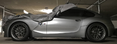

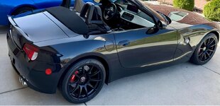

Example Photos
So far I've found the following examples with known specs for both wheel and tyre sizes:
Example 1:
Front: 18 x 9.5 ET22 with 245/40/18 tyres
Rear: 18 x 10 ET25 with 285/35/18 tyres
Example 2:
Front: 18 x 8.5 ET38 with 235/40/18 tyres
Rear: 18 x 9.5 ET22 with 255/40/18 tyres
Example 3:
Front: 18 x 8.5 ET38 with 235/40/18 tyres (and a 10mm spacer)
Rear: 18 x 9.5 ET22 with 265/35/18 tyres
Example 4:
Front: 18 x 9 ET42 with 245/40/18 tyres
Rear: 18 x 10 ET25 with 275/35/18 tyres
Example 5:
Front: 18 x 9.5 ET35 with 265/35/18 tyres
Rear: 18 x 9.5 ET35 with 265/35/18 tyres
Example 6:
18 x 10 ET25 with 265/35/18
Example 7:
Front: 18 x 9.5 ET35 with 255/35/18 tyres
Example 8
Front: 18 x 10 ET25 with 275/35/18 tyres
Example 9
