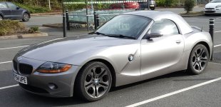

I really need to know what SE ride height looks like, I need to lift up the front of my car and want to know if buying SE springs (and shocks while I'm at it) is going to accomplish this.
This is my car with the maxton lip kit on standard sport suspension. It's far too low at the front and I basically can't drive it anywhere except Wales ...which is a problem seeing as I live in Ireland :D
Any photos? Even better if it's on style 107s :thumbsup:
Thanks!
Here you go. Mine is on se.
Hi Peter. How are you mate ? I recently switched back to my SE springs and also fitted new Bilstein B4s. The N.Wales Run was the 'shakedown' and for my style of driving the car feels sooooo much better ! It was on its original '03 Sachs shocks which were knackered. The car sits about 20mm higher all round but is so much more driveable and comfortable that I'm just not bothered. The above photo was in the Yorkshire Dales last Sunday and is how the car looks now. My wheels aren't 107s, they are MV3s but the same 18" sizes :D
