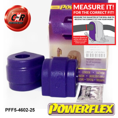

Just ordered the above for my car and think I have ordered wrong size as I have "sports suspension" which reading up looks like 25mm bar, not 24mm.
I cant seem to find any 25mm anywhere - i take it the slightly smaller ones wont fit.

Here's an option
I don't know if the 24mm ones fit, but when the 24mm ones are so cheap, I'd probably buy a test pair to fit, even if you then upgrade to a better make 24mm
My car is a sport, and has new rubber ARB bushes. I doubt they're from BMW, so I suspect someone managed to fit 24mm versions, but I can't confirm that
cheers all...measurements at 25mm. I did replace them with some cheapo ones a good few years back from eurocar parts. They would have been just standard ones I guess.
No, they fit perfectly. In fact i struggled to get them on. Just passed its MOT as well.
