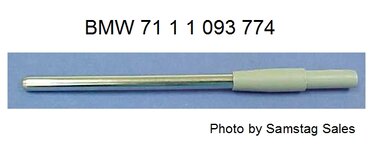

BMW sells them, They come in the tool kit from the factory from other models,
But as you can see its a plastic end and it doesn't really secure very well,
It just "hangs" in the lug nut hole and it would have been better if you could thread it into the hole,
