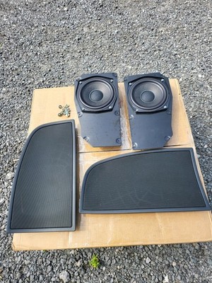

Stuart - with your optimum system can you explain more what you did please? Did you leave all speakers the same (including keeping the hole where the door midrange should go) and just add woofer to augment the mid ranges in the bulkhead? If so, and excuse my ignorance, how and where were they mounted, where did the wires come from to feed them, and what speakers did you use please ? Thank you
Exactly that
Holes in the doors as they were
No changes to other speakers
I wired the subs to the cables that run up the back of the rear firewall
Note also- there are 2 types of speaker available I believe with different impedance: @Zedebee knows which is which but I believe the lower resistance are better
As for mounting I usually seek out a job lot that has the speakers, brackets, cables and connectors, sound deadening and bolts. You’ll also need the expanding rivets in the holes that it attaches to
If you pop one of your cubby holes out you’ll see where they attach to and where the wires run

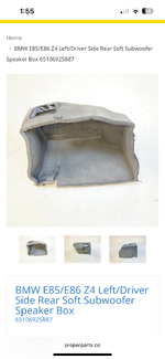

Okay thank you. Again as a numpty I presume these woofers are in their own enclosures? Can you remember what you purchased please? Sorry for the questions but I need to do the research and there doesn’t appear to any bespoke woofers for the E86.

I recently stripped out a six speaker system and replaced it with a ten with the extra amp, all OEM. This was a great learning experience for me, but I wouldn’t recommend it due to the cost (c.£500) and effort involved.
If you are sticking with the basic amp (head unit), you can add door speakers (cheap and easy) or bass speakers behind the seats (significant investment in speakers, mounting plates, foam boxes and grilles). But I wouldn’t do both, as the amp probably can’t cope with that much load. Also, if doing the bass speakers, you should stick with the 4 ohm version that match the footwell speakers, not the more powerful 2 ohm from the 10 speaker system. Don’t go near the 10 ohm subs from the DSP system, as they won’t work without the DSP amp.
