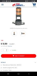

For future reference for anyone else with the same issue...
The part number for the OEM alternator is 12317837691
A quick Google of "12317837691 slip rings" throws up a link to Online Car Parts (looks to be another version of the German sites, autodoc, buycarparts etc.). Where their article number for the slip ring is CQ1070001.
That shows a couple of options, the most 'expensive' being this one for £5.50. Does this look to be the correct one at 52.1mm? Also, is there anything else that I'd need/would really benefit from being changed? It's already got a new voltage regulator with the brushes, and the bearings aren't giving me any issues atm so dont really want to go through the process of changing those. Thanks

Double check that you have a Bosch alternator and not an alternative, if it's Bosch it should be OK. Alternative (complete alternators) are interchangeable, but internal components might not be.
