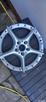

Hi everyone,
I'm also going to be respraying my BBS split rims.
Will i need to split them in order to do a good job? I will be doing them in the same silver colour across the wheel.
If anyone knows the correct colour code for the wheels then that would be great.
Thanks

Hi Daniel,
OEM colour code/name for Style 108 rims is:
144 - Felgensilber
They will need to be 'split' in order to get a decent finish on them which unfortunately increases the cost!
I have some center sections in good condition with original Titan silver paint for very little money
