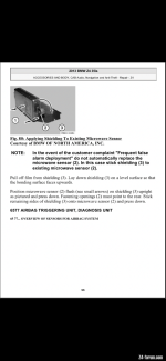

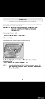

The part needed is just a piece of foil according to many BMW garages BMW have produced a specially shaped version which sticks on. Attached are the instructions they will follow to install it (needs to be done in both doors). I’ve done this on mine. I am going to do it again though as it still goes off in torrential downpours, so I’m going to try two layers of foil. It is much better than it was though.
I’ve not heard the bonnet sensor being the cause of this on an E89. This can be a cause on the E85, which is why it might appear on Google searches.
To still lock the car, without the alarm, do this:
1. Get out of the drivers side and close the door.
2. Get into the passenger side and close the passenger door.
3. Press the “lock the doors” button in the centre of the console.
4. Get out of the passenger door.
5. Push down the door lock knob on the passenger door and close the door.
6. It should now be locked and the alarm will not be on.
I’ve done this from memory so hopefully it is right.

Thanks Ianl
The way to not set the alarm does seem to work so handy to know. My neighbours say thanks :)
Car has had the fix of the 2 door sensor things. So far seems ok but we have not had really heavy rain yet
Cuprat said:
Thanks Ianl
The Dealer did the "Fix" on a previous E89 I owned and it was 100% successful :thumbsup:
