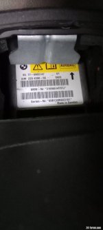

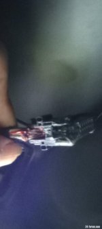

Had a local Z4 2.5 in today with an airbag light on, cause is a burnt plug to the central module and burnt pins on the module. Car is a Copart purchase after it was written off by insurance for a large dent in the drivers door deemed uneconomical to repair. The airbag plug might have been due to the car being jump started some time before purchase causing power surge but that's just a guess. Looking at replacement module and plug so the plug can be spliced into the loom. This particular module has quite a few compatible modules listed as exchangeable and have already found one with its plug and short loom. Awaiting owner to decide on what he wants to do.
Car is a 2003 Z4 2.5 and in excellent condition approx. 74k miles on it and the only other fault is a leaking cam cover gasket which is an easy fix, far too good to be a breaker.
