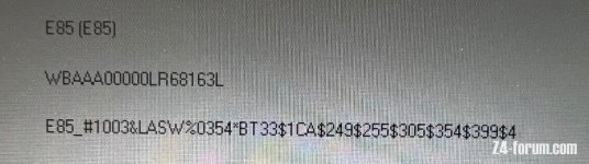

Yes, I followed the alt method using update ZUSB and it automatically chose 695146. Perhaps I entered the Vin prior to selecting the family however from the pic I posted earlier the VIN is displayed during the flash.

Please see Winfpk UIF info for Sim85, it has the correct last digits displayed for the vin. When I look at another model in the air bag system the vin is displayed as Yyyyyyyy, this is same for the original entry on Sim85.

Looking at all the airbag modules, SBSL2 and SRSR2 have the funky yyyyyy VIN associated with them. STVL2 and STVR2 would not report in Winfpk UIF, it would error out, no response from unit.
I only changed out the main sim85 module, should I flash SBSL2 and SRSR2 with the VIN.
What is the reason for the yyyyy VIN on these other two modules.
