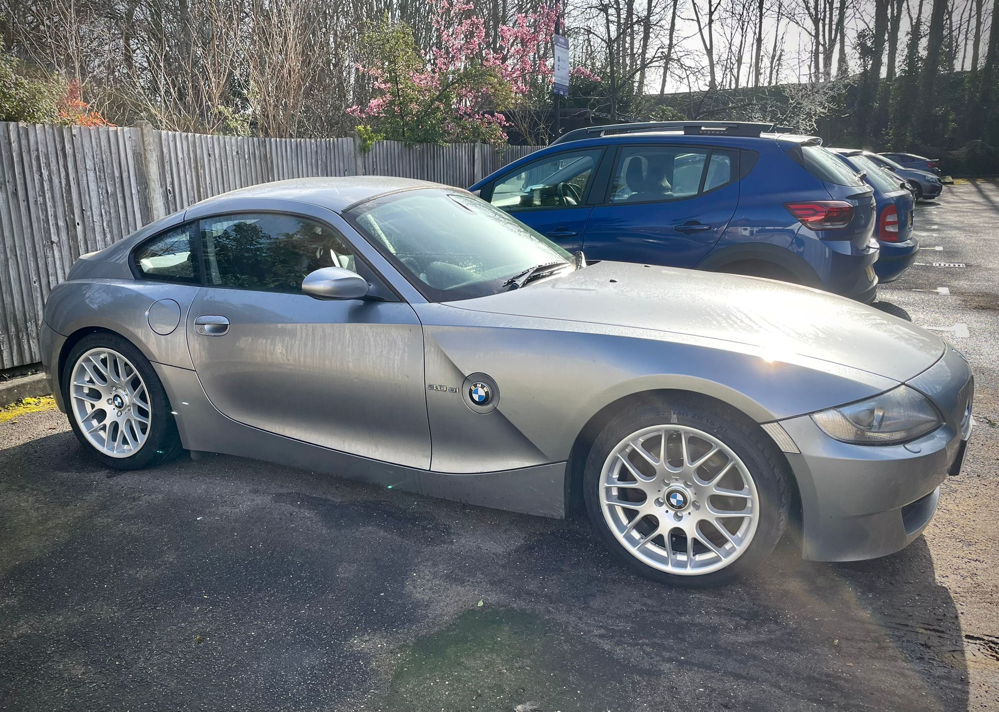

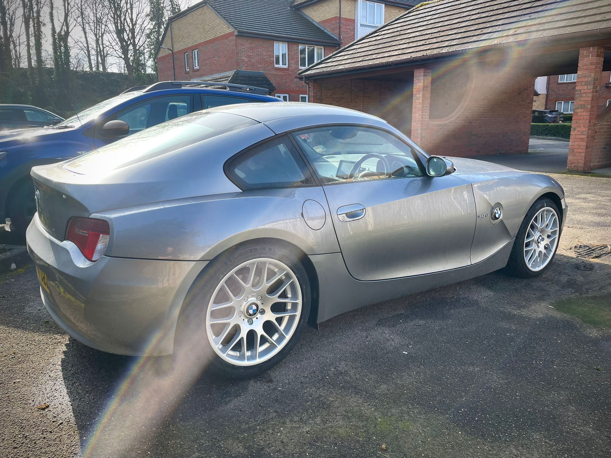

I went with the 18" Rivas from BM Autosport in the end, with some Continental Sportscontact 7s; also got an E46 space saver and found a bag for it on Amazon which fits it perfectly. I haven't driven it much yet but can already tell the ride is much improved, and the steering even feels a little sharper, plus I think it looks much better. Thanks to everyone for your advice.
(Yes it needs a wash!)
