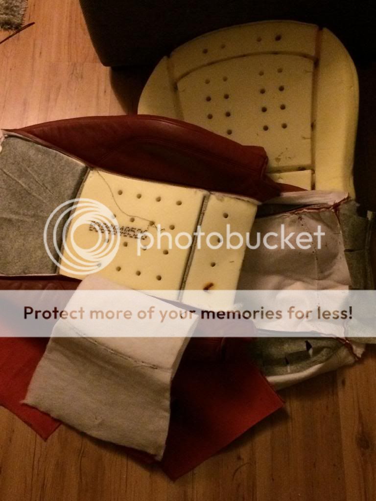

You would need yo obtain the switches, wiring and sear heater mats.
You would also either have to modify the seat cushions or buy new ones.
You wouldn't need new cushions, the mat is stitched into the leather. I cut a complete set out of a set of standard Z4 seats.
