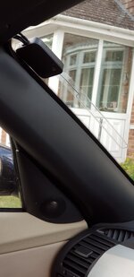

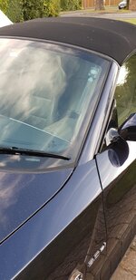

The model I installed was the 300di, as in the ebay link in the post above from AnilS. So there may be differences I'm unaware of, but my antenna looks like this...
The mistake I made was mounting it too high up the screen and onto the black strip - it needs to be about 10mm lower and off the black. The 'base' of the antenna (black box bit) stopped the windscreen headrail trim being replaced so I had to cut out a small section of the trim. Impossible to see, but annoying that I made the mistake

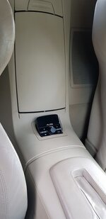

For mounting the controller I didn't want to drill the dash and neither did I want to use the sticky pad option. So I obtained a spare piece of aluminium dash trim (so to return car to stock in future maybe) and cut a section out of it at the top for the cable to pass through; using tin snips and a section of chromed steel sheet (cos we've all got some of that at the back of the garage
- actually mine came off one of those stupid toilet roll stands) I crudely fabricated a bracket and stuck it to the trim with epoxy, as shown here...
There was no magnetic grounding tail with mine - where would it go on a roadster?? - but a sticky strip.
