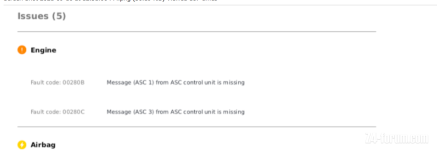

The motor was eliminated by supplying 12v and it spun without issue. So in my case it was the module. I replaced the module and most lights went away (REd handbrake turned amber, low pressure and dtc went away)..
