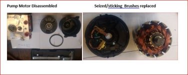

ABS/DSC Pump Motor failure - seized brushes. Fault Code 5DF0 - DIY brush repair kit available on Ebay
AMBER ABS / BRAKE / DSC Lights
The ABS Pump motor failure due to seized brushes is well documented and can be fixed by either sending it away or as I did buying the new brushes and installing them. This meant removing The ABS / DSC unit. Drilling off the Peens securing the motor. Disassembling the motor, re-soldering in the new brushes and then reassembling the pump using araldite to secure the Motor to the Aluminium pump housing. I have also drilled and tapped 3mm Dia x 4mm deep into the pump body and fabricated 2 securing bars.
Kit included brushes and a new bearing, important to measure shaft set to bearing before disassembly. ( I used a disc cutter to remove inner race) The fault lights cleared and no reprogramming was required. ABS fully functional after brakes bled using INPA tool to activate ABS motor pump.
