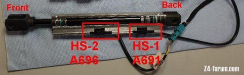

The wiring for hall sensor HS2 (I think that's the correct one for A696 as opposed to HS1 for A691) has been rewired from sensor to the plug direct
I am going to check for continuity and resistance- what should I be looking for values wise?
Can anyone confirm that the wiring should go from the sensor to pins (37 for Brown) and (29 for Red) please however these colours may be incorrect due to rewiring... possibly was yellow/brown???
Have a look at the correct assignment:
Roof fault A696 Hall sensor
https://z4-forum.com/forum/viewtopic.php?p=1843524#p1843524

Black 26-pole connector
HS-1
Pin 8 brown (signal)
Pin 21 grey (VCC)
Black 41-pole connector
HS-2
Pin 37 brown (signal)
Pin 29 red (VCC)
Important for all connectors of these hallsensors:
color to color (i.e. yellow to red)
brown to brown (!)
