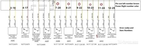

Read the error code, and it was A68B.
After taking a look (at this point, roof was maneuverable / accessible by hand), I noticed a very small speaker sized wire that had snapped. After touching the wires together, I noticed that I could move the roof again. I twisted the wires together and wrapped in electrical tape, and was able to get the roof to close.
As soon as it closed, I was able to move my windows again. I took it for a drive, and as soon as I hit above 30km/h, the car started bonging again, and wouldn't stop till under. Stopped, and noticed the roof wouldn't move again. Scanned, and got the same A68B.
I figure my likely bad attempt at "fixing" the wire wasn't good enough. The problem is I cannot get the roof into position to take another look. I've tried turning the front screw on the hydraulic pump .5 turns, I've tried using ProTools to force movement of the roof, but I can't get the rear portion up to check the wire. Is there any way for me to do it, or will I have to take it to a dealer or an indy?
