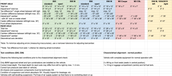

I made a table of alignment setting when getting mine done (in yellow) earlier this year:
Started with the M3 CSL settings in mind but ended up quite close to Z4MR specs.
[ref]MrPT[/ref], Thanks. I will print that off for reference - maybe even take it to the garage with me. :thumbsup: (but like you said in my thread, will probably stick to standard set up first).
