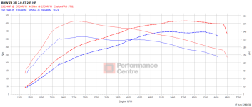

For any one thinking of remapping their 28i, I had mine done today...
Stock - 241.3hp @ 5360rpm Torque - 365Nm @ 2904rpm
Remap - 282.4hp @ 5739rpm Torque - 465Nm @ 2759rpm
That looks like a good gain, with the torque I would imagine it pulls so much better now :thumbsup: :driving:

Its interesting that their dyno seems to follow the manufacturers orginal numbers quite closely across the 18i 20i and 28i Z4s that they have done..
As far as you can tell do they 'tweak it' on several runs or is it loaded with a run just to confirm the numbers / all ok?
Yes, they ran it at least 3 times. They did show me a graph for a 18i that produced 284hp, can't remember the torque figure.
I was impressed with the torque on mine

Evolve ran mine up on the Dyno 3 times after mapping, no tweaks in between but to let the ecu adapt itself to the new parameters. It showed small increases on each pull :thumbsup:

Being sad I looked at the various Z4 N20 graphs they posted...what I don’t yet understand is why the the torque curves of the re-maps seem to vary quite a lot but the end bhp graphs are relatively similar...or maybe it’s just the way it comes out..what’s amazing compared to the old days of highly tuned engines is just how broad and flat even post tweaking the torque curves are and even more the bhp curves..huge areas of torque and bhp...you can’t say they are peaky, allied to my favourite gear box you have 3 gears for almost any situation.. :rofl:

Maybe the difference stems from super unleaded fuel as opposed to normal fuel, it might be knocking the boost down and impacting on the torque. Max bhp is more a question of peak air flow the turbo can shift? :?

We custom tune every car individually, this particular car had 3 software revisions, we make changes based on the power curve and various datalogs that we record while the car is on the dyno. The N20 platform is one we k ow and love, having bought a 320i many years ago to use as a Guinea pig for our software development.
The main channels we look at are:
Requested load
Actual load
Reference load
Ignition timing
Boost pressure
Intake air temperature
Fuel pressure
An average N20 makes around 440nm and 285bhp on 99ron fuel at stage 1, but this can vary from car to car, last week we managed 430nm and 290bhp on a 328i using 95ron, which is an extraordinary gain on a car with such poor fuel.
We carried out 8-10 runs on the dyno on this car today, testing and logging various gears and software revisions.
This paticular car loved the low rpm and midrange power, but didnt seem as happy to respond to increases in ignition timing at higher rpm, so we impoved it where it was happy through the midrange rather than forcing it do do something it wasnt happy with to try and chase a big bhp number at very high rpm.

We actually carried out 12 dyno runs. This image shows the difference once we had snoothed out the ignition timing and boost profile through the midrange.
