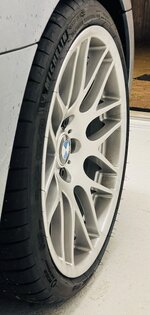

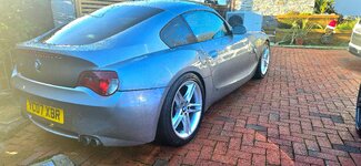

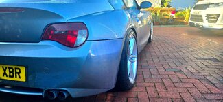

224s with 20mm rear spacer and 15 fronts is absolutely perfect.... sitting on bc racing coilovers ..... would recommend a 40profile front tyre if you wanna go super low to avoid rubbing... but moderate drop on 45 profile will be fine... pics to demonstrate

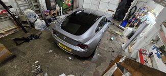

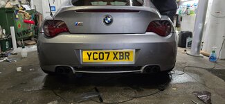

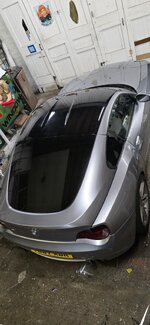

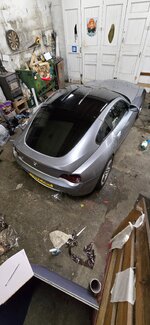

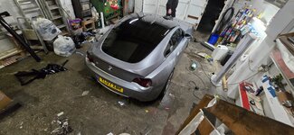

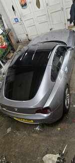

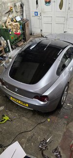

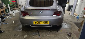

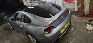

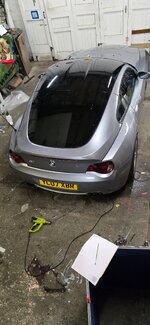

My mods for spring so ready for summer right there. 👍🏻
Tinted the rear lights while i was there 🤷 whats your thoughts?

I ran Eibach springs and OEM dampers with 12mm spacers all round and removed the camber pins at the front to increase negative camber. I used 224s as track day wheels and CSLs for the road. It tramlined like a pig, especially with the wider 19" wheels, but understeer on turn in was reduced and it looked great without any rubbing. It cured the vague, floaty front end north of 120mph too.
I'm now using a very different setup that rubs at full lock and breaks my teeth over the smallest of divots in the road surface, but the handling on smooth tarmac is phenomenal!
