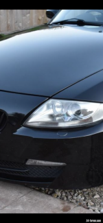

Im trying to track down what sort of replacement headlight I need (driver side). It’s suffering from major condensation and rather than dry it out I’m looking for a good used part that I will charge back to the garage I bought the car from.
If anyone can help me uncover what headlight unit it is I need i’d be very grateful, if you have one for sale as well then I’ll probably fall of my chair with excitement.

should be part no 63127165690 I'm not sure about any differences in number between lhd and rhd but that throws up some for sale if you google that number

Those look like xenons to me (I see headlight washers). So you'll pay a premium for that, because they aren't very common at all!

are they not halogens with one bulb projector one bulb non projector? my e86 has headlight washers but i'm almost certain I don't have xenons?
xenons have no leveling system on the light module, as per this photo:
halogens have two "wheels" - one adjusts the level of the light output. This is automatic on xenons.

Thanks everyone, I don’t have the dial for adjusting the beam level (it doesn’t this automatically on start up) so it sounds safe to assume that I have Xenons. Great for illumination, sticker for replacing.

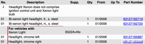

Have you tried realoem with your (last 7 digits of) vin number?
I would guess that all xenon headlights off a facelift z are the same part number though...
I got this from realoem (what a great website by the way!), so it looks like it is part number 63127165688.
It looks like there are a few options around the £450 mark, which is a shed load better than the bi-xenon I had to buy for my 535d.

Probably, but you might be able to 100% double check with a dealer’s parts department. Indeed, they should be able to tell you the part number based on your chassis number AND sometimes their prices surprise you (granted, that works both ways - crazy cheap or crazy expensive ha!)
