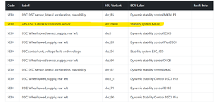

The inpa error says:
5E30 Querbeschleunigung Sensor elektrisch defekt
Which translates to:
5E30 Lateral acceleration sensor electrically defective
... So CoPilot is probably hallucinating. (how can error 5E30 be pressure sensor #1) When the direct translation says "lateral acceleration sensor"?
Where do I go to find authoritive source for error code 5E30?
