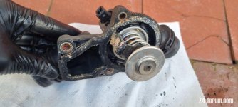

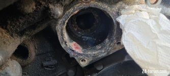

03" E85 M54B22 Coolant Colour
By the very light red in mine I am fairly sure it has been changed to the newer clear universal coolant and the colour is just a bit of old residue. This was confirmed by a hygrometer which showed a high level of protection (minus 30) and the bitter taste to the coolant. This will be birtex or whatever it's called which has been added in recent years to stop people poisoning cats. Now theres a thought!!
