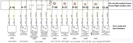

I’ve got the constant bong / red roof symbol coming up , the fault is showing 00A698 rear end module open during driving fault
Just wondering if any one could point me in the direction of which micro switch/ hall sensor this is on the roof mechanism and I can look into anything obvious there,
I have searched the forum and found a few threads but there mainly for a 00A696 fault
