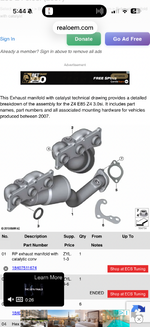

I have an M54, the manifold should look like this, right?
What numbered part should I look out for?
