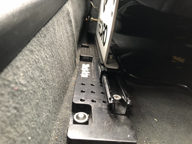

I bought the 'hybrid' bracket that allows you to use both road belt and harnesses. This is a thin rail with a 90º bracket at the back, so the belt attaches to it on the door side, and the buckle/pretension attached to the transmission tunnel side.
I got most of my bits from CA Automotive when the were a thing, and this is the hybrid seat belt bracket I bought (which is not strictly needed if you're sticking with the standard 3-point belt)...
I didn't get an emulator, as I got my hands on a relatively cheap, new, genuine seat occupancy mat that I fitted under the Recaro cushions. But if you have a later model than mine and have the passenger airbag deactivation switch, then you may not need an emulator at all).

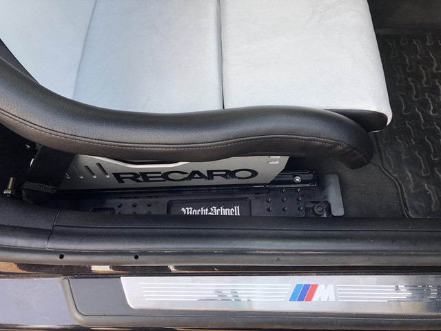

You can 'just' about see the bolt/bracket where the door side belt is mounted to the rear of the Recaro mount / logo...
Those were Macht Schell ones, but you can get smaller/simpler ones, just for the 3-point belts, like these...

Thanks @mmm-five - just to be clear did you get the 90deg bracket piece for both tunnel and door side? Does the buckle connect to this or to the side of the seat mount on the tunnel side?
I got a pair of the hybrid set for both sides...but I've not got the car with me, so can't see how I've attached the seat belt buckle receptacle (it's very tight in there, so might not even be able to get a photo anyway) - but I'd assume I've simply connected the receptacle to the lug on the outside of the bracket...as I did for the seat belt on the other side of the seat.
I did see some offerings where there was simply a 1" square block welded on the bracket that could only be used to screw the original items into - so the difference is simply these being hybrid and being able to screw a harness mount into them as well.
