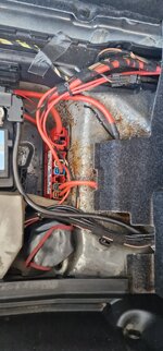

I went to look at a Z4 30i in Glasgow today for a fellow forum member as I am in Scotland for a few days with work.
This is a 2009 car, one owner and full history with the usual dealer approach of talking it up and setting an interest grabbing £8,995 price tag.
First issue I found when I arrived was that the price on the card in the window was £10,995 :unsure:
Asked about that and quickly advised "sorry, someone has put the wrong price on the car, it is £8,995"....
On the surface, the car looked lovely with beautiful bodywork and extended cream leather interior.

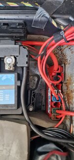

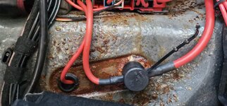

Then I opened the boot and lifted the cover over the battery...
I stopped looking at the car at that point and it is fair to say the sales guy was not happy when I said there was no point in going any further as the corrosion caused by water ingress is siginificant!
So, in summary, if you notice a 1 owner 2009 Z4 30i for sale in Glasgow, don't, just don't!

I'd be tempted to give the dealer the benefit of the doubt on the basis most won't think to look under the boot floor but the only way to know would be to phone them and ask them the direct question you should always ask before viewing an E89 - "any signs of water ingress in the boot and does the sponge surrounding the roof motor feel damp".

There's been, most likely, a water leak via boot seal or rear lamp seal failure..
Apart from cosmetic issues the concern is that several of the expensive / fragile ECUs in that area may suffer water born damage..some of which takes years to manifest if not addressed immediately..
EPB, diversity amplifier,EKPM amongst others
View attachment 291198View attachment 291199
