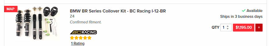

I was thinking on getting BCRacing BR series coilovers
But from reading the page, it says that I will get, minimum, 2in in drop. Which sounds terrible from my current experience haha, not sure if those 2in in drop are comparing to a stock z4 and not a z4 with sport suspension.
The alternative will be to get some good shocks, like Bilsteins B6, but since the cost is very similar I'm unsure on what to do. Will I really get a 2in drop with coilover coming from a car with sport suspension?
