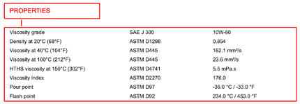

You can usually find this info on the spec sheets for each oil., and lets you have a look at their relative performance at low & high temps to ensure the oil you're buying isn't too thick/thin at cold/hot temps.
Tech sheets for the two you mention are linked below, and in the 2 examples, the Motul stays thicker than the Mobil 1 at 40ºc and 100ºc, but the Mobil 1 is more resistant to shear although is a blend not a full class 5 ester base.

Motul 300V Le Mans 10w60
Mobil 1 Advanced 10w60
Other popular, value for money options are the Fuchs Titan Supersyn 10w60 and Millers CFS Nanodrive 10w60 and Castrol Edge Titanium 10w60 (although usually on offer at Halfords for a similar price to the Fuchs/Millers ranges)..but they're both a bit stingy with sharing their full spec sheets...and they're not ester racing oils...so more similar to the Mobil 1 composition/performance at a much lower price.
