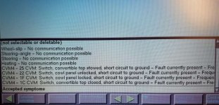

I attached the laptop and found these errors in the roof module.
I've tried to erase the errors, but they don't disappear.
I'm now stuck with a roof that wont work and is stuck down. Anyone any ideas?

Is that with the SmartTOP removed, module replaced and after battery reset?
Yes.
But before I did the laptop diagnostic before disconnecting the battery.
But then I removed the battery for 30+ mins and the roof error light was still flashing and no change. So yes, all these errors will still exists.
Not necessarily. If you've removed the SmartTop and reconnected as normal, then reset the battery it's worth reading the codes again and trying to clear them.
I can't imagine how you'd introduce a short with what was fine before without it being caused by damage. If you need to raise the roof you can pull the red lever in the boot to bypass the motor and lift it by hand. It's all detailed in the manual.
I trust the micro switch in the boot was not touched at all?
I've still not able to get my roof working, but after another look at it the other day, I've discovered the cause. There was another connector I wasn't plugging back in!!
I was plugging connector A back in, but hadn't seen there was a smaller connector - B. This was right down at the bottom out of sight. Seems silly now missing this. I can't remember removing it, so maybe this smaller cable fell out when I removed the roof controller module.
The problem is that I can't get it plugged in. There's simply not enough slack on the cable to get it pushed back into the block. I've spend two hours trying and got no where except lots of blood on my fingers!
