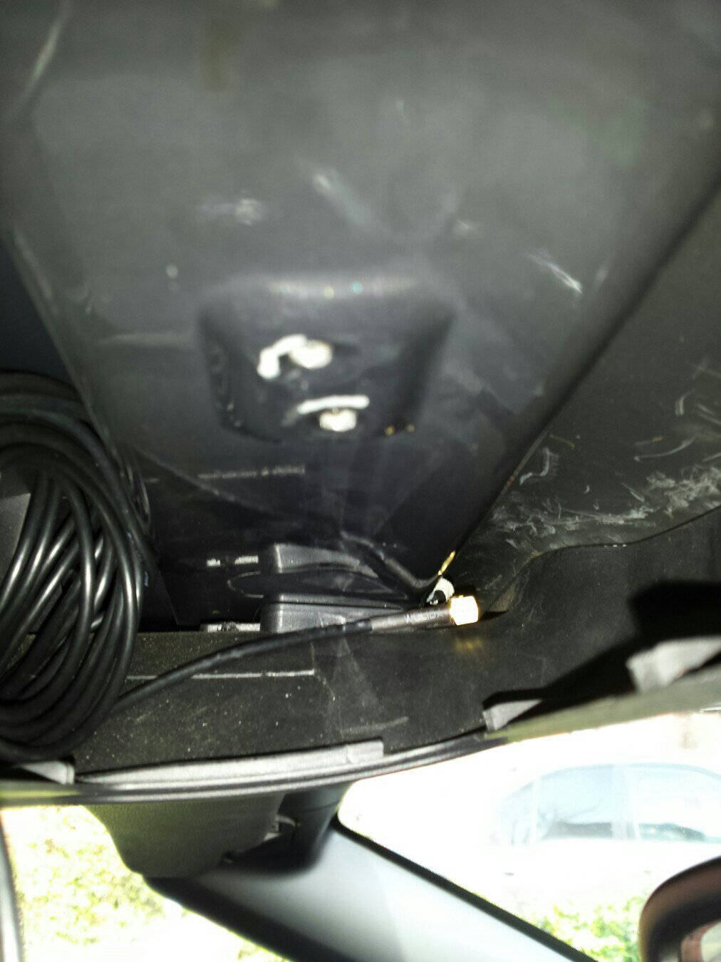

Now to change it : the antenna is located behind interior light, there is a short connection which can be pulled apart. Being a lazy sod i did not want to remove all the trim to get to the back of the DVD drive to plug the antenna in., so thought i would be able to get at it through the interior light
Removing interior light it's fairly easy i started at the left hand corner and gently work my way down with a small screwdriver, it's on spring clips at the front ,when you can get your fingers in you can pull it down obviously be careful
Disconnect the interior light you can now see the nav antenna it's held up with two philips screws
Remove the screws and you can pull the antenna apart
The next bit is a little more tricky the connection for the antenna was held to the body of the car with duct tape, and was impossible to get your hand in push the new connector together, so with a little gentle persuasion and screwdriver i managed to remove it from the tape, this meant i could pull the interior trim down at the front and push the sat nav antenna through so it hung down on the windscreen.
This now meant i could connect the new sat nav antenna, and test the sat nav was working
Once the new antenna was connected within 10 minutes sat nav was up and running again
To refit the new antenna, thread the new antenna through the hole left by the interior light, gently pull down the trim and push it out so that it hangs down on the windscreen. With both ends of the antenna now hanging down by the windscreen it easy to connect them together, you can push the connected antenna back through the interior trim .
Then coil up all of the excess cable and push it up into the corner
Now simple attach the new antenna to the old bracket and screw back up
Reconnect the interior light push back into place job done.
