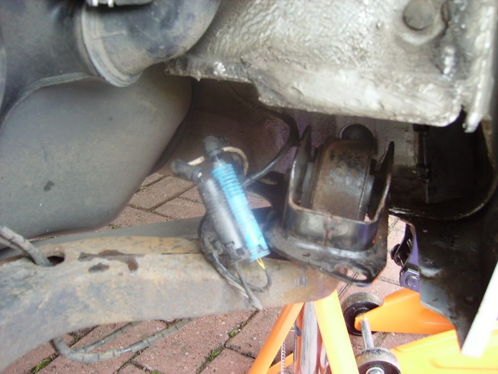

Remove screws holding brake pipe on wishbone, one on top of wishbone and one on back (just visible in pic with socket on it)
With a marker pen draw around mounting bracket onto body (this will help when re-assembling back onto body)
Remove 3 bolts holding the mounting onto the body, undo box with brake sensors in and unclip sensors from the box!
Then push down on wishbone!

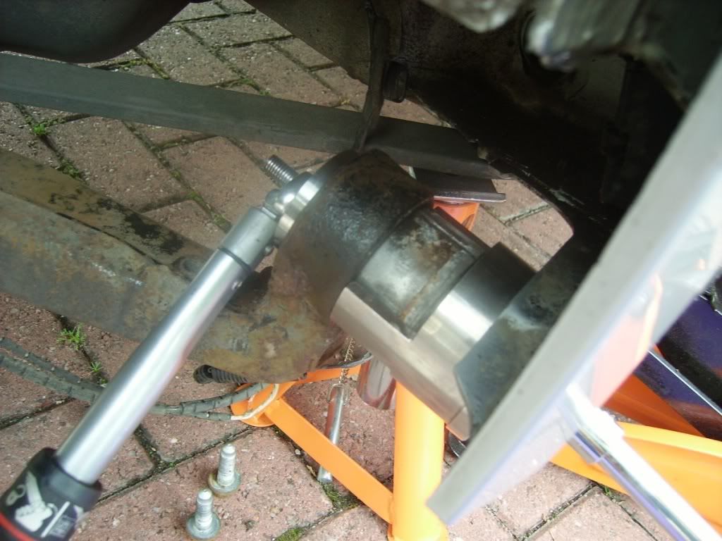

Put 10mm high tensile all thread through bush with nut and washer on the side nearest the wheel arch and hollow cap on the out side with nut and washer, use socket spanner on one end and ring spanner (wrench) on other end and slowly do up nuts.
With a hollow cap with cutouts on the side you can see the progress!
Nearly out!!

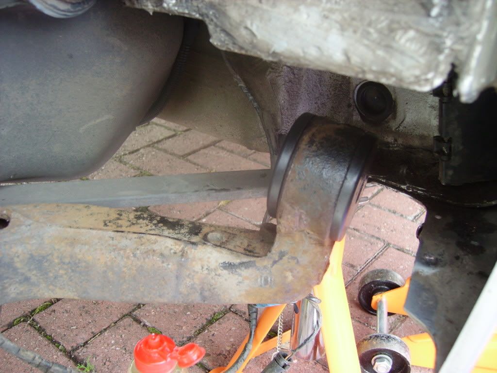

Push in one of the new bushes, but the side in the photo has a nice lead on it and the bush will slide in with no problem. I found it easier to install the other side of the wishbone first using allthread to pull it into wishbone because there is no lead on that side and used a bit of washing up liquid to help lube and then i did this side.
Both sides in!
