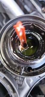

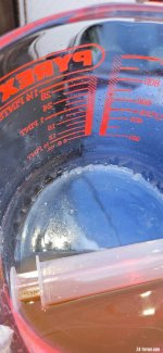

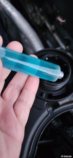

A few days ago I decided to check the coolant. The level was ok but it was hard to tell the colour, as the expansion tank is black.
I checked it and the old coolant had barely any colour, just a slight grey tint to it. I simply syringed some out and it was pretty much colourless, semi-transparent.
Today I took my car for a coolant flush to a local BMW indy.
When I picked the car up, I asked what kind of coolant had been used and the two people at the reception desk couldn't give me a specific answer, just "pink". BMW's OEM is normally blue and the spec is Glysantin G48.
I have emailed them and hopefully will be taking my car back tomorrow to have both issues rectified.

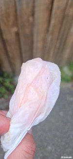

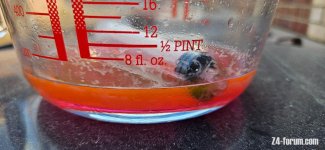

Should I be concerned? What could be the issue that has caused the whitish/very light brown oily and slimey residue?
By the way, they used a radiator cleaner product called Normfest radiator cleaner. (Normfest 2897373) but that does not explain why the residue is slimy AND oily to the touch.
This residue in the coolant tank has appeared AFTER I took the car to the workshop. It wasn't present before...
Could it be the mixing of coolants? Perhaps using a funnel or a container contaminated with oil?
Another (worse) possibility would be the oil cooler gasket failing but they would have had to drive the car really hard while with them for it to suddenly leak...having said that, there was a Google review where a customer (who had a tracker) complained about his car being driven very fast while being road tested.
I hope this is not a sign of something much more serious... :(
Any advice will be much appreciated!

Varixto wrote: Tue May 20, 2025 6:20 pm This residue in the coolant tank has appeared AFTER I took the car to the workshop. It wasn't present before...
I wouldn't immediately worry, but I would want the correct coolant to be used.
Having had an oil cooler gasket fail I can't recall any visible contamination, but I did run a system flush/cleaner through before doing two plain water flushes. Easy with the electric pump to ensure it all circulates but far too time consuming for a garage.
I, personally, wouldn't be going to an alleged BMW specialist that doesn't use the correct spec fluids.
Do you have the time/ability/interest to start DIY?
My F10 had some crap pink coolant in. That was oily. You may be onto something with them possibly using the same equipment for oil/coolant. Now I use a clean 20L bucket and vac filler for coolant changes.

Well, I have just left the workshop and the manager told me that they would flush it again and put the, G48 instead.
He told me that the coolant was correct (I guess to save face) in spite of the colour but agreed to do another flush and fill up with blue G48.
He said that the residue was due to the product used in the flushing, which takes a little while to fully eliminate, picking up grime, etc... from the bowels of the coolant system and then finding its way to the expansion tank.
Well, I would have thought that if they repeated the procedure enough times, that would not have been a problem but as I have never used a coolant flush fluid before, I will give him the benefit of the doubt.
He told me that over the next week or so, as the car gets driven, some more stuff might come out of the expansion tank. He suggested either to syringe it out and top up with clean one or do what I did and use a kitchen towel sheet, dipping it and using as a "filter" to catch the residue (like I did in one of the pics).
