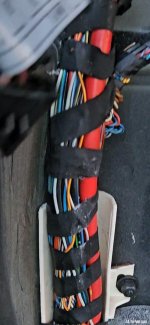

Ok from this photo there is a blue and yellow wire which may or may not be the wire you need but its running to the boot with the positive lead to the battery.
If you remove the drivers seat and trim around the door you will be able to lift the carpet up find these wires.
Run a cable from the rear light wire and have one prong on the multimeter on that wire and stab the other prong into blue and yellow wire under the seat carpet and see if you get a continuity reading.
