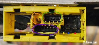

The airbag light could be related to the steering wheel airbag.
Start with the passenger seat first as you have a problem there also.
Top down, if you have electric seats remove the 4 nuts/bolts for the seats rails and the bolt for the seat belt, disconnect the battery and wait 30 minutes. Unclip the seat belt from the shoulder clip whilst waiting. After 30 mins remove the wire harness under the seat.
Lift the seat out.
Under the seat you'll find this:
If you have electric seats there will be a block connector on the left. The heated seat connector is on the right with red, blue, yellow dots.
Circled purple is for the occupancy sensor mat, circled green is for the seat belt clip and circled orange is for the pretensioner.
Do not put a multimeter on the pretensioner circled orange unless you know what you're doing. It could fire off the charge.
Clean all the pins with contact cleaner or isopropanal alcohol. Do not use WD40 or similar.
On the heated seat connector red and blue are the heat pads circuits and yellow is the temperature sensor wire. If the temperature sensor wire is faulty you'll get a flashing light on the heated seat button.
Put a multimeter on the red and blue pins and do a continuity check. You should get a low resistance reading of 005 or similar, much higher and you have problems. If higher follow the wires back and you'll find you can split the back rest and seat base elements. Now resistance check those separately to check the readings.
This bit is optional, get familiar with the under seat yellow block connector. Slide the yellow block off the seat support, cut the cable tie off wire support, slide the black cap off the top which exposes the back of the connectors. Pull the black connector blocks out and push them back in.
Now when the seat is back in the car you can fiddle with the yellow block connector knowing how it works.
Put the seat back in, connect everything and then connect battery.
Try and clear the airbag light. Now test the seat heating and occupancy sensor by going for a drive like slippery shoe above has said.
Now read the codes.
If same fault codes for airbag you can try the following.
Disconnect battery. Wait. Pull out yellow connector, pull out purple circled block connector and leave it out. Connect everything back together. Connect battery. Now check codes. Do you get more fault codes? If no then it's the occupancy sensor.
If yes then the occupancy sensor is fine and plug it back in. Whilst there remove the pins circled orange, isolate them separately with tape and connect back up. Again check for fault codes.
If you get no extra codes then it's faulty. If you get no extra codes then something else is causing the airbag fault.
It will be a lot easier if you cam get hold of a known working seat and just swap them out. Needs to be a facelift seat. Doesn't need to be a M-Sport seat.

Usel wrote: ↑Sun May 05, 2024 8:37 am The airbag light could be related to the steering wheel airbag.
Lift the seat out.
Now read the codes.
slipperyshoe wrote: ↑Sat May 04, 2024 9:46 pm As mentioned I have a similar situation since mine sat without charge and was jumped multiple times. So far I’ve replaced the module (which are apparently coded to the car but the matching part number appears to have worked) but I’ve got two new fault codes relating to the airbag deactivation switch and telltale passenger airbag off (93D2, 93BE). Hoping to have someone have a look over the weekend with more of an idea than me so will keep you posted. It may be that I’ve stilll got a module that’s not coded properly, or I might have another issue. So basically I’m afraid I’m not much help!
As you said, often a fault is pointed at the mat sensor. Someone in an older thread quite logically suggested having a passenger sit in the seat with no seat belt. Once you hit 10-15mph the seatbelt sign should come on if it’s working. Seemed like a good suggestion to check it the analogue way!
Thank you all! I’ll definitely try that seat belt trick today. Really appreciate the write up Usel. It’s probably beyond my skill set, I’ll break something so I’ll print it off for the garage and they can give it a follow.

I’m in Penistone if you want to come over I have a code readerAbbas wrote: ↑Sun May 05, 2024 11:36 amUsel wrote: ↑Sun May 05, 2024 8:37 am The airbag light could be related to the steering wheel airbag.
Lift the seat out.
Now read the codes.
It will be a lot easier if you cam get hold of a known working seat and just swap them out. Needs to be a facelift seat. Doesn't need to be a M-Sport seat.slipperyshoe wrote: ↑Sat May 04, 2024 9:46 pm As mentioned I have a similar situation since mine sat without charge and was jumped multiple times. So far I’ve replaced the module (which are apparently coded to the car but the matching part number appears to have worked) but I’ve got two new fault codes relating to the airbag deactivation switch and telltale passenger airbag off (93D2, 93BE). Hoping to have someone have a look over the weekend with more of an idea than me so will keep you posted. It may be that I’ve stilll got a module that’s not coded properly, or I might have another issue. So basically I’m afraid I’m not much help!
As you said, often a fault is pointed at the mat sensor. Someone in an older thread quite logically suggested having a passenger sit in the seat with no seat belt. Once you hit 10-15mph the seatbelt sign should come on if it’s working. Seemed like a good suggestion to check it the analogue way!Thank you all! I’ll definitely try that seat belt trick today. Really appreciate the write up Usel. It’s probably beyond my skill set, I’ll break something so I’ll print it off for the garage and they can give it a follow.
Paddy - I’m based in Huddersfield, West Yorkshire
