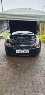

It begins! Vanos x 2 done, check out the vid to see the state of the 2nd / lower vanos . Still got an engine flush and oil change to do buuuuuuuut! Locking wheelnuts and no wheel nut key put an and to that. I was intending on draining the oil whilst the front was up to free the brakes so it's off to soft play with the kids.. Thankfully, BMW Edinburgh are getting me a replacement key for next to nothing tomorrow - hoping it's a match to what's on there.. They look original.
Car is booked in for Monday for an MoT and I'm away all weekend - I'm hoping the caliper swap O/S front will be straight forward tomorrow. Concerns about the drivers door being stuck disappeared when it popped open as is should!

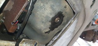

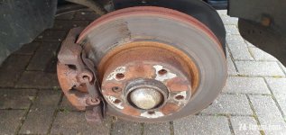

This poor Z hasn't had a lot of cuddles in its life. I think it's sat out in rain since it's last MoT over a year ago. Both front calipers weren't just siezed, the pistons were rusted, they looked like they'd been at the bottom of the sea,obviously scorched too.
Upon trying to do the oil change, the service hatched watch srmcrewed shut with with weird self tappers and a a cable tie just for luck.. Worse than that, the sump plug is just spinning .

1. Finish fitting new front calipers and pads, brake bleed and then check rear calipers and pads, (not going in with high hopes).

Question time. What to do about the sump?
I've noted that the sump gasket is a bit weepy, no surprise there.
Plan 2.
My Oil level sensor is throwing an occasional code, so:
1. Removed the engine tray.
2. Remove the Oil Level Sensor - a messy affair with the oil in - for inspection and also draining the oil in the engine.
3. Remove and replace sump, gasket and potentially an oil level sensor if it appears to be defective.
4. Finish oil change!
My biggest idiot moment was putting engine flush in the car already, (again, no oil history wanted to make sure it was degunked) stopping me from driving it to a garage to get help with the sump. I could still tow if I get major issues.
Any thoughts, recommendations or problems with my plans I'd be really grateful to hear.

If that plug is spinning it could well be a stripped thread in the sump.
That would probably mean finding another sump pan.

Can the oil not be sucked out the top through the dipstick with a pela pump?
No dipstick I assume?

Dropped at the garage this morning to replace the sump. I could have gone heliocoil but kind of glad I didn't as it was quite weepy around the sump gasket. I've got a used item from a breakers and getting it replaced. It's a subframe off job which is a bit beyond me.
They also found a sheered lower steering column bolt but the uncertainty now is that one of the sump bolts has sheered coming off and they're not sure that there wont be others - so I've asked them to proceed. At some point that gasket was going to need repaired as was that bolt that would probably have failed the MoT.
Report is going to come back on Monday and they may have to drill and Heliocoil the some bolts now which is unforeseen expense buuuuut... One glimmer of hope I'm hanging onto was that I drove to the garage , (still with Wynns in it) slowly. No exhaust noises, no emissions lights and to be honest, everything felt great. So fingers crossed the worked proceeds without too many more hitches and it gets a clean emissions pass on Monday.

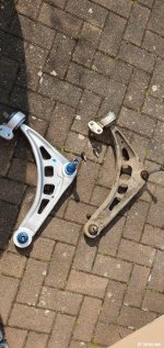

Almost stacked the front control arms replacement. I tightened up the subframe mount OS before getting the Lollipop in place, (don't ask - I don't know why either). After deciding to move onto the other side to see if I really should have had everything attached loosely before tightening anything up I realised the error of my ways . Finished the nearside and got back into the offside which is more of a PITA anyway. Split of the hub ball joint ( which thankfully hadn't been tightened - much) and got down to carefully but with much effort levering and lining up the lollipop and hand tightening the bolts as much much as I could until I was sure everything was located and wasn't threading - (thinking of the helicoil notes in TIS). Boom, it worked.
Now - the car still isn't road legal for a couple of reason but I'm lucky to have a couple of quiet roads around that I could road test it. Previously, driving it to a garage it felt like it would just veer off into a ditch, what a difference! I went for Meyle HD and they feel great! Going to get the same on the rear once we're road legal. A downside to the work was noticing how much of a state the rest of the suspension is but that's a post for another time although I am thinking about coil overs from EBC etc, something 'packagey' that's straightforward to swap in.
