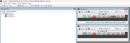

Hi everyone this is my first post here after being a long time lurker.
I have a 2003 z4 3.0 and I am trying to tinker with and learn how to tune/mess around with the ecu. I wanted to first raise the rev limiter but I am can't find the xdf definition files for the ms45.0 in order to use tunerpro. I tried a file on the ms4x wiki but the tables look all screwed up so I am assuming the file is for a different dme version.
Does anyone know how to find the software version for the dme or which xdf file I need and where to find it? Also is there a way to check if I have the correct xdf file?

You can identify the software version from either looking at the file you pulled from the ECU in a hex editor, or by querying the AIF with WinKFP or Tool32.
Creating a new XDF for your software version is a time consuming process and requires you to find the bin that matches the existing XDF, from there you can look at the location of each map and pattern match that within your bin file.
If all of this a bit beyond you, then i'd suggest paying someone who knows what they're doing to do it for you.

I know this is complicated but I am willing to learn how to work with the ecu on my car. Can you or anyone else point me in the right direction for at least how to find the DME version? Is creating an XDF file from scratch the only way to get it or can I find it anywhere online for my DME version?Martyn wrote: Thu Sep 21, 2023 9:54 am You can identify the software version from either looking at the file you pulled from the ECU in a hex editor, or by querying the AIF with WinKFP or Tool32.

I am trying to learn how to work with and tune the DME for my car. I am going to start with just raising the rev limiter for now. I have an 03 z4 with the m54 and ms45.0 and I have downloaded the _MPC.bin and _FLASH.bin files using ms45 flasher. I tried using the only XDF file from ms4x wiki in tunerpro but none of the tables looked right and boolean values weren't only true or false. I just want to know what to start with in order to be able to work with the BIN files in tunerpro.
